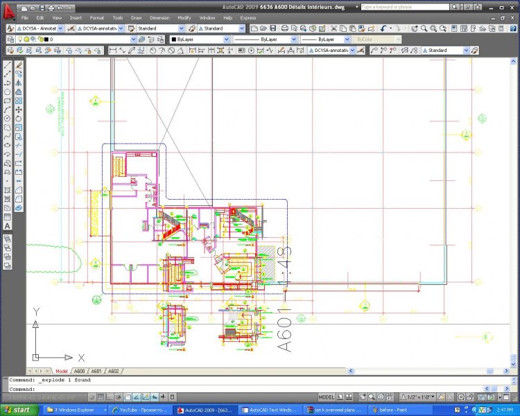

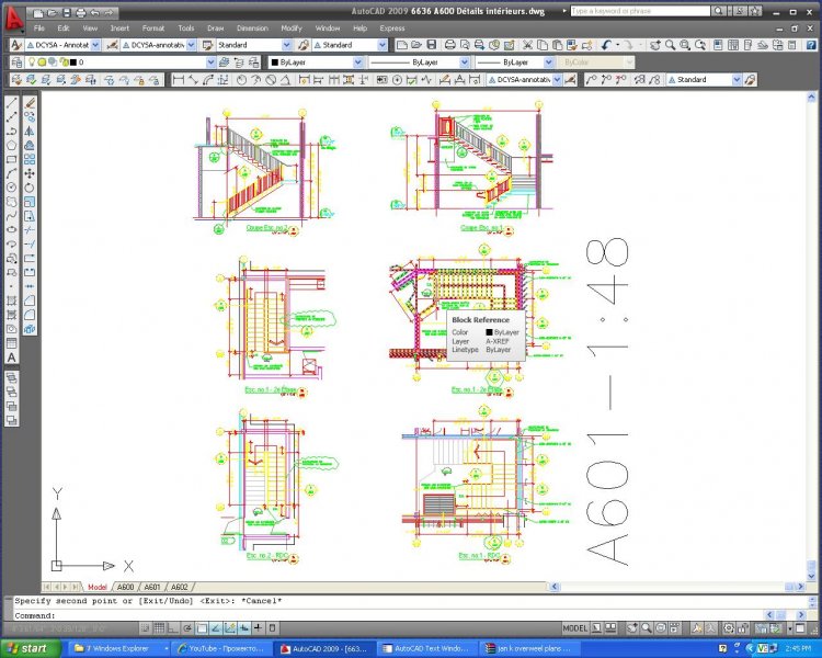

I have binded xref somehow but then its a block (and whats good about it,is that its shows the small area i want to work on) when i explode that block, it becomes a drawing to an original size.
q. can i retain the size of block but being able to modify pieace?

1pic.before. block.which was xrefed before i bind it
2pic.after.after exploding block it changed size.which was not what i wanted

Just rescale it, either before or after you explode. The original file was most likely scaled 1/2" = 1'-0".
original iz 1/2 =1 and its the same after......before the stair detail was exploded, it was a part of a drawing whith area of interest zoomed in
after exploding i have huge area to show a small detail.
