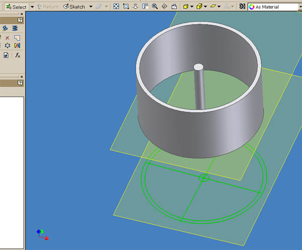

You can extrude a copy of a .dwg file in Inventor. However the cad file imported is only a reference.
Here's how I've been successful at working with imported dwgs.
First make a new sketch plane parallel to the one you want your 3D sketch to be on (use shortcut ]). The offset can be anything.
Now import your cad sketch onto that plane and if necessary move it to the location you want it to be at.
Close that sketch and open the other sketch plane that you want your 3d object to be on. Now Project the cad lines onto this sketch plane and copy over the lines and curves (AI will snap to them). You can now extrude this copy.
