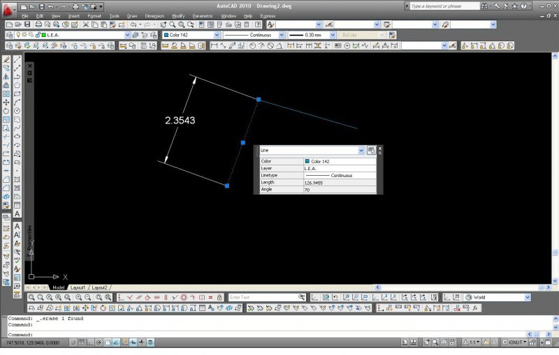

I want to know why the line length shown by the Quick Properties window does not coincide with the quota size. To calculate the lengths of arcs, lines, polylines tlen.lsp selected using an order made ​​on the net and I calculated wrong ( the size of the Quick Properties ). I deleted the line and I drew it again and same problem occurs. Attach a capture.
That is a very interesting problem. Type in "list" and pick your line...I bet you find that it's z-axis coordinates are off.
I agree. Remember AutoCad is not only 2D, but 3D also. The length it gives will be that of the 3d line, not the 2D representation.
Exactly this was the problem. One end of the line have nonzero z coordinate. Thanks very much for your help!
