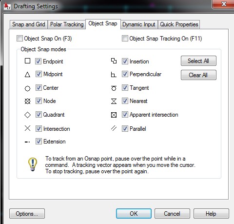

Jadgpanther Posted April 15, 2011 Posted April 15, 2011 HI fairly often I find that when using object snap, the settings for OS modes seems to lose its memory, the OS modes box pops up and I have to keep checking 'select all' see attached, is this just a bug, or is there a way to stop this happening thanks Quote
MSasu Posted April 15, 2011 Posted April 15, 2011 You can create a new button and use the above string on Macro field - please take care that there is a space at the end of the string. ^C^COSMODE 15359 Regards, Mircea Quote
Tiger Posted April 15, 2011 Posted April 15, 2011 Is it loosing it between commands or when you open AutoCAD in the morning? If you set OSnaps duringa command, that setting is not remembered (sometimes at least) when you exit the command. If its loosing it between AutoCAD-sessions, try saving your workspace. Quote

Jadgpanther Posted April 15, 2011 Author Posted April 15, 2011 Tiger happens between commands, MSASU what does the command ^C^COSMODE 15359 do ? thanks Quote
Tiger Posted April 15, 2011 Posted April 15, 2011 so if you set OSnaps when you have no command active, does it then change OSnaps while in a command? Do you use anything but standard LT, any plugins that can mess with your OSmode? Quote
MSasu Posted April 15, 2011 Posted April 15, 2011 what does the command ^C^COSMODE 15359 do ? The current state of OSNAP modes is stored in a system variable named OSMODE – by setting it to 15359 means that all modes are selected and the feature is active. The suggested button is intended to reset this system variable to the state that you are looking for. Regards, Mircea Quote

Jadgpanther Posted April 15, 2011 Author Posted April 15, 2011 thanks all, yep, the ^C^COSMODE 15359 button is way to go , me thinks, nice one Quote
