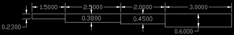

how to write a lisp program for drawing which is attached to this thread
i am thinking like this
a. using getpoint for getting the lower left corner coordinates
b. 2 foreach loops will come for length and depth
but i could not get how to write the 2 foreach loops in the program
can somebody help me to find the solution
thanks

see my drawing (sample.dwg)
i will set the 2 lists as below
(setq length (list 1.5 2.5 2.0 3.0))
(setq depth (list 0.23 0.38 0.45 0.6))
my intension is that top horizontal linea are at same elevation but lower horizontal lines are differenet with respect to depths
1st pick the lower left corner from the getpoint
and draw vertical line with depth 0.23 and draw top and bottom horizontal lines
with a lenth 1.5
and then start second rectangle with depth 0.38 and lenth 2.5 again it should start from the left corner
ans so on
i am asking how to write this lisp
can any body help me
thanks
You don't need two FOREACH cycles to achive that (by doing this will get 25 rectangles instead of 5). Please check if this is what you are looking for:

in ur program rectangles are overlapping.
i am required as shown in the sample.dwg
can u modify it
thanks
Sorry, I don't have now access to AutoCAD; can you post a picture? Thank you.

So, please find below the fixed version:

thanks Mircea,
i got the same
but you are taking the pick corner as upper left corner
if the selected pick corner is lower left corner
what would be the program
can u modify it
thanks
Sorry, the reference point isn't marked on your sketch... so, please check the code below to see if is the right one:

thanks Mircea,
i got it
but one more thing is there
u are using rectangle
in my case, lines are needed
if we use line is there any change in the program
can u modify it again
thank u very much
Here you go:

thanks Mircea,
but in the program only first rectangle only picking the lower left corner
for other rectangles again it goes to upper left corner
in some cases, there must be some gapes in between rectangles (ie gaps 0.23 0.6 0.45 etc)
if that is the case every time it should go to lower left corner while drawing rectangles
can u modify it again with gaps in between the rectangles
thank u very much
Sorry, but really don't understand your explanations - so, why don't you try to edit my code to suit your needs? Just post your attempt and I will provide you support. Also, please post an image to help me understand the desired result. Thank you.

hi Mircea
yeah u have lot of patience
i tried ur code which suit my requirement
finally i got what i want with ur guidance
thank u very much
