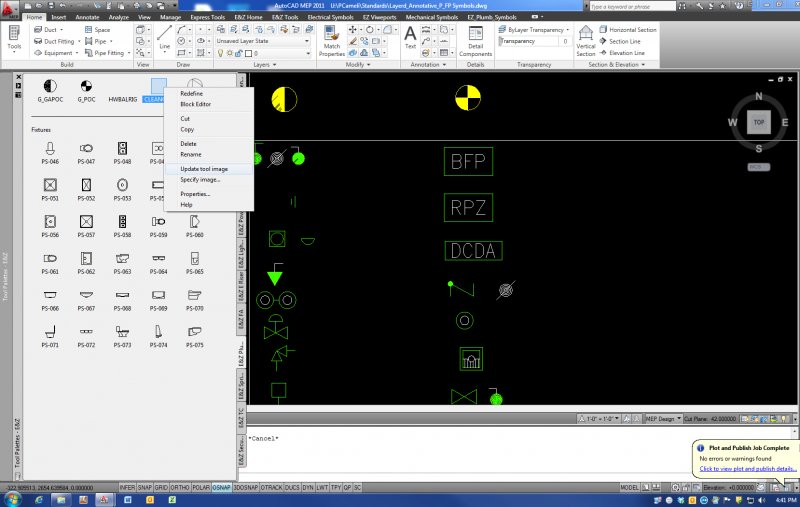

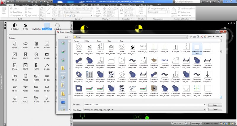

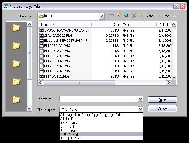

I've created a master file that contains all of my blocks. I then drag and drop the blocks onto my palettes. For many of them I can just hit the "update tool image" and it displays as a black and white version of how it appears in my master file. There are some however that appear as a blank box, only the text appears.
I tried "specify image" but the image in the default image directory displays as a blank box, just like on the tool palette. How does Autocad generate the images used for the tool palette icons and what is the variable that causes some to be created perfectly while others display as blank boxes?
I've attached some pictures.
