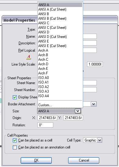

Can anyone pls let me know how to add create a1 & a0 Borders in micro station many thanks in advance:D
bugout69, I am assuming you are using a newer version of MicroStation. There is a definition file that you can edit in Notepad to add additional border sizes. Depending on the version you have installed it may vary.
For MSV8iSS2 it will be located here C:\Documents and Settings\All Users\Application Data\Bentley\MicroStation V8i (SELECTseries)\WorkSpace\System\data\sheetsizes.def
XM MicroStation and earlier versions of V8i may vary in location but you can search for the file sheetsizes.def
