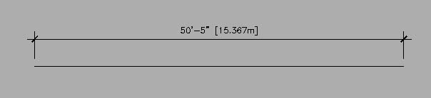

i have drawing using autocad but the dimension is 50'-5" its in feet and inches..the prblrm is i want to convert into mertric.advise me what to do.thanks
You do not say what you want to do with the converted dimension.
If you merely want to know what the metric equivalent is arithmetically, then divide 5 (inches) by 12, then add to 50 (feet), then multiply the whole by 0.3048 and the answer is in metres.
If you have a dimension on the drawing, then activate Alternate Units and make the Alt scale factor 0.0254, and you will see metres as well as feet and inches.
There are other possibilities, but we are not mind readers, and can only give you help as you ask.
Edited by eldon
added units
