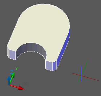

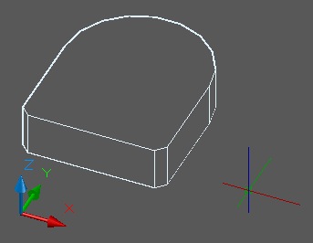

As for parametric design, I fully understand the difference between a 'fixed' design like AutoCAD, TC and many other CAD and then parametric design SolidWorks, Inventor, ProE and maybe others, but the question is not parametric related, but in general how to modify the profile that was used as base for the extrude.
Lets say I have the profile, then I extrude it and then after that I need to insert an arc like shown here. In this case I had to create the arc, then extrude and subtract it, which works in this case, but it would definitely be easier to be allowed to modify the orignal profile, and insert the arc right there.
Jesper
The way you did it, by Subtracting the Extruded arc, is the way its done in Autocad. You could have also just created a Cylinder with the correct radius, moved it into position and then Subtracted it from your shape.

Jesper, Solidworks is parametric feature based design, autocad is not. You must use the boolean operations , union, subtract, intersect (and more depending on which version of cad you are using) just as you did above. There is no reference to the original sketch lines used to created these solids. Once the solid is created you must EXPLODE the solid to retrieve the defining curves, in which case you can modify them, re join them and re extrude them.
