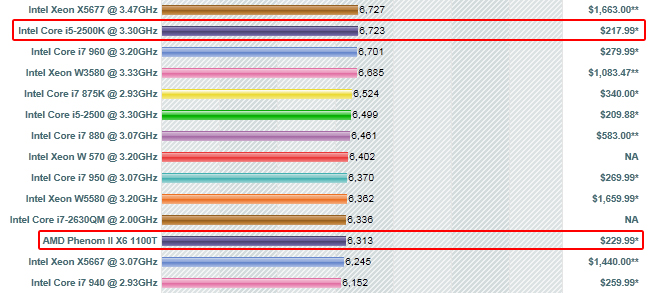

AMD CPU 6 Core 3.3 GHz price 229.99 copared to $1069.00 price was listed above?????
Uh, you mean an Intel proc that outperforms the 1100T that's actually cheaper??
http://www.cpubenchmark.net/high_end_cpus.html

I was comparing the price for that 6 core intel I7 to the AMD 6 core 1100. The bench mark isn't that much different from the AMD to the Intel, what .4 better on the bench mark. Also you are comparing the I5 and that is only a 4 core. I'm not trying to argue with you. I'm just saying for the money that was posted on the earlier posts I would go with the AMD. I'm running right now a dual core AMD Ph II X2 565 Black Edition Stock speed at 3.4 GHz with 16 Gigs of ram at 1333 MHz with 2 500 Gig HDs mirror 1 At it handles 100 mega bite drawings. Honestly if I could find that paper that I got from Autodesk on how autocad uses multicore CPUs, I would scan it and post it. I will try to explain what it stated from memory here. According to the sheet, autocad only uses 50% of core #1, and from there, the CPU usage degrades by 50% of core #1 to 25% for core #2 and 50% of core #2 to 12.5% for core #3 and 50% of core #3 to only about 6% for core #4.
