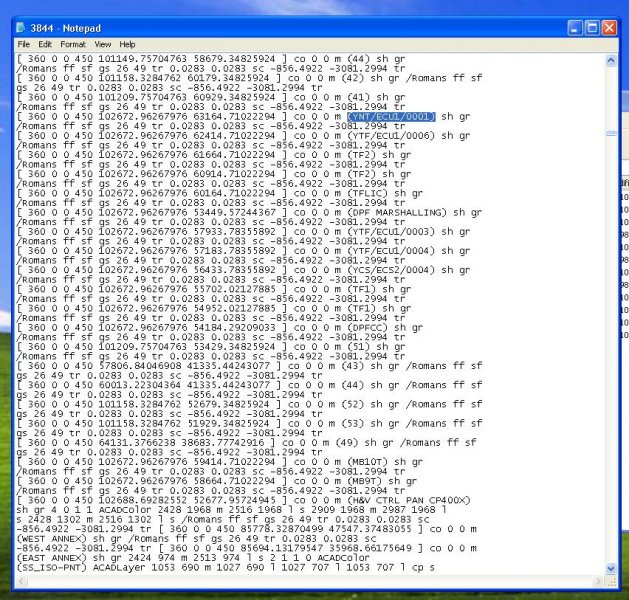

an addition
this is what i need it to look like (the marked bit) which doesn't seem to work when you use it in autocad 2008 :(
anyone got an idea if it's just a setting i could change somewhere or do i need some sort of plugin?

i'm not sure.
will i be able to open and edit a pc3 file with notepad? i need to insert coordinates so the database can read the file properly and show me where certain things are around site.
