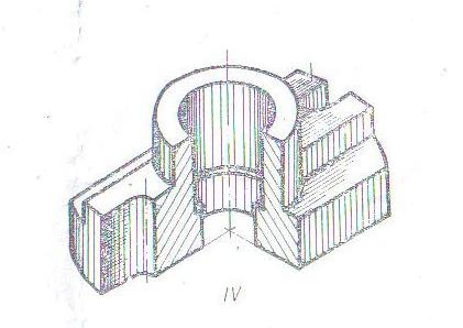

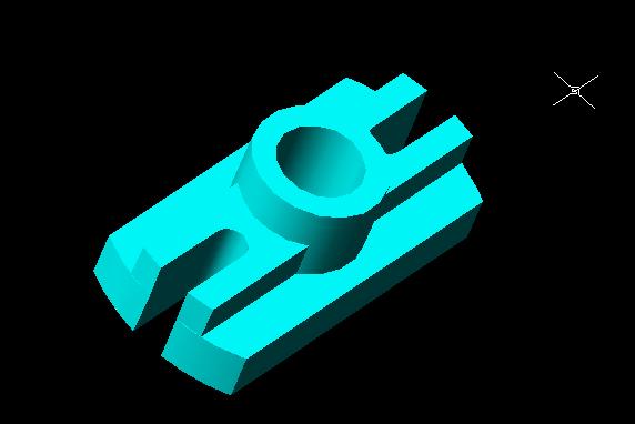

alexandlu Posted April 30, 2011 Share Posted April 30, 2011 I have a problem with sectioning this object. Could anyone help me? I am attaching here the 3d object and how it should look... Quote Link to comment Share on other sites More sharing options...

alexandlu Posted May 1, 2011 Author Share Posted May 1, 2011 I dont know in what points to slice it. i only succeded on cutting it half Quote Link to comment Share on other sites More sharing options...
fuccaro Posted May 1, 2011 Share Posted May 1, 2011 You could draw a cube with an edge superposed to the axis of the central hole, than subtract. Quote Link to comment Share on other sites More sharing options...
ReMark Posted May 1, 2011 Share Posted May 1, 2011 You could also draw a polyline with a 90 deg angle, Extrude it, then use the Slice command with the Surface option to cut your 3D solid. Quote Link to comment Share on other sites More sharing options...
