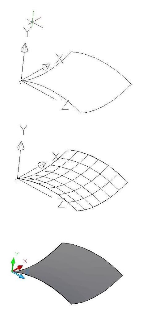

the edgesurf command will allow you to build a mesh surface from 4 closed polylines. Here is an example i just drew. I used 4 arcs.
while the lisp works on mesh faces, acad 07-09 has surface to solid build in. I dont know where it is on 2008 but i know its there.
