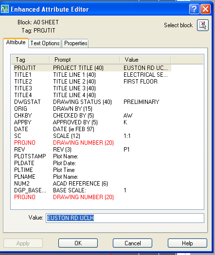

How come this happens, I'm just editing a titleblock and want to display the drawing number in both the top right and bottom left of the drawing. I want it so that if one is changed automatically so is the other.
Anyone know why It appears red here?
Silly question but have you checked the colour in the properties tab under each row?
It always show in red when you duplicate (same tag and prompt) attribute in one block
can I not do that if I want both values to read the same?
they're not linked I have to put them in twice...groan, how do I do this?
I just want to type a drawing number once and both outputs will reflect that.
Just came across this the other day - you are correct each attribute has to be original maybe link it with a field i'll have a play
Yeah done it - you have to give the other one a different name maybe put a 1 at the end. then link it with a field to the other attribute and select the tag in the property column. Hmmm Maybe i need a screen shot!
Ah- ha! ...just off to learn about fields now.
