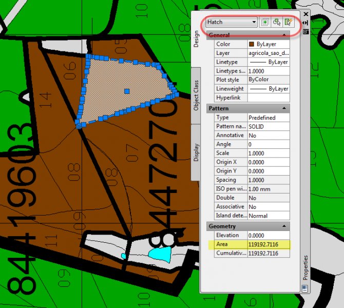

nargothrond Posted May 6, 2011 Posted May 6, 2011 Hi!! Im new here, and really really sorry if this topic is in the wrong section!! My trouble is: I work with maps, and i hatched a area, with a irregular shape, now i want to know this area, how can i proceed?? I already selected all area and clicked on properties to see Geometry information, acumulative... Did the List Comand.. and nothing.. any ideas?? Tks! Quote
SLW210 Posted May 6, 2011 Posted May 6, 2011 Does your shape boundary have some overlapping? Try posting the file if you are needing a solution. Quote
nargothrond Posted May 6, 2011 Author Posted May 6, 2011 Yes, have a lot of layers, how can i post the file?? with the link?? sorry, im new here!! Thanks for the fast reply! Quote
SLW210 Posted May 6, 2011 Posted May 6, 2011 That is just an image, it would help if you posted the file. You could try drawing a rectangle around the whole area and issuing the Boundary command. Quote
nargothrond Posted May 6, 2011 Author Posted May 6, 2011 Here is the link of the file.... it is big!! https://rapidshare.com/files/460958060/geral_2010.dwg... tks Quote
SLW210 Posted May 6, 2011 Posted May 6, 2011 Here is the link of the file.... it is big!! https://rapidshare.com/files/460958060/geral_2010.dwg... tks I cannot access rapidshare from work. Did you try .... You could try drawing a rectangle around the whole area and issuing the Boundary command. Select the hatch and open properties.... He claims to have tried that one. I already selected all area and clicked on properties to see Geometry information, acumulative... Did the List Comand Quote
rkent Posted May 6, 2011 Posted May 6, 2011 SLW210 The OP wrote I work with maps, and i hatched a area, with a irregular shape, now i want to know this area, how can i proceed?? I already selected all area and clicked on properties to see Geometry information, acumulative... I wasn't really sure they had selected the hatch because they write "I already selected all area and...". I couldn't tell from that what they had clicked on. Quote

Murph_map Posted May 10, 2011 Posted May 10, 2011 Works for me if the HATCH is selected. BTW the OP can really make use of AutoCAD MAP3D for this type of work. : ) Quote
designerstuart Posted May 10, 2011 Posted May 10, 2011 i don't understand.... if there is a polyline around it this can show the area, or selecting the hatch itself will show its area - how come LIST doesn't work? Quote
Murph_map Posted May 10, 2011 Posted May 10, 2011 i don't understand.... if there is a polyline around it this can show the area, or selecting the hatch itself will show its area - how come LIST doesn't work? My guess is the OP did not select the hatch but something else (the dwg has an Xref "image" in it) or they have a bad install of AutoCAD, missing SP or poor workstation performance. Quote
