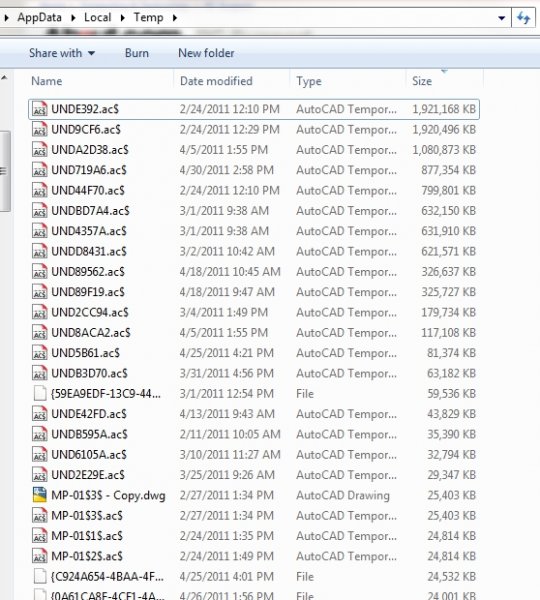

tzframpton Posted May 9, 2011 Posted May 9, 2011 I know that the *.AC$ file is a backup file. I believe it's the "undo" backup file if I'm not mistaken. I occasionally run WinDirStat on my computer just to see what has accumulated and to my surprise, I have a few AC$ files that are extremely huge, almost 2GB's worth in two different files. The date is a couple of months old and I was wondering if it's okay to get rid of these files without possible repercussion with a DWG file or the program itself? Do these AC$ files attach themselves to a particular DWG or are they newly created per session of DWG? Thanks in advance. Quote
ReMark Posted May 9, 2011 Posted May 9, 2011 .AC$ files do not contain any useful drawing data. They are temporary working files. Ditch them. Quote
rkmcswain Posted May 9, 2011 Posted May 9, 2011 Agree with ReMark. We have a startup script that runs at logon that empties the %temp% directory of anything older than "X" days.... Something to look into... Quote
BIGAL Posted May 11, 2011 Posted May 11, 2011 Also sv$'s and baks that will be written to your temp directory, I search also for plot.log this pops up every where, Dwl's .err if you crash quite a few get left behind, recover dwg's did you rename and re save. We have directory C:\acadtemp easy to find and monitor We move our completed jobs to a seperate area and delete baks as a regular task (plot = new bak) we have 15 years on line. Then you get into the windows stuff .tmp .log We have 60GB split 2x30Gb C: & D: thought put 2012 on D: 25gb free no crashed! need about 6gb free on C:to install and it took away 2gb on c: once complete hence cleanup all the time, dont start on our IT not removing rubbish from their compulsory upgrades. Quote
