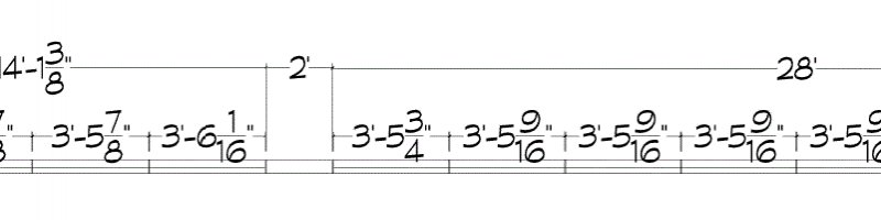

In the example below, I would like to select the three dimensions 14'-1 3/8's, 2', 28' and be able to move them all up or down at the same time...how do I do that?
I would use the STRETCH command
Ditto.
Meaningless text so I can post my one-word response.
Stretch doesn't seem to work the way I would like it to. I was hoping I could select the dimensions and move the grip of one of them and that would move all of the dimensions up or down at the same time.
That's the way _STRETCH works on my AutoCAD.
What does that even mean?
I use stretch for this very task (on occasion), and it allows me to take multiple, in-line dimensions.
I goofed on something, my bad....it works great! Thanks
