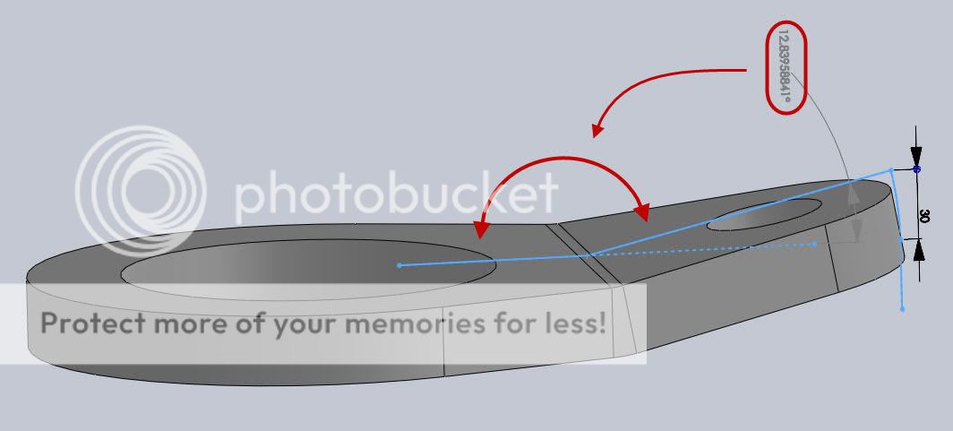

Matt - Thanks for the reply. Unfortunately the dimension I'm using to drive my bend angle is itself driven by a linear dimension, and it seems that 'Link Values' isn't available...
In the image below, I have the sketch in blue which is intended to provide the angle, by specifying the bend distance (in this case, 30). In Inventor I would normally just use the driven dimension to drive the bend angle... In Solidworks I can't figure it out.

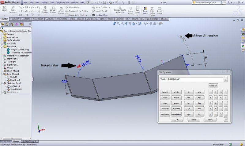

Try this. Right click the equations folder and select add equation. Type in "Angle=" then select your driven dimension. In this example the driven dimension (angle dimension) is "D4@Sketch1". Now when you create a sketched bend you will have the option of linking to Angle. In this case angle = to our driven dimension. Does this help?
Got it... Thanks for that.
