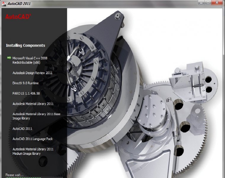

When you installed Autocad, did you choose to install the complete material library or just the base image library?
i choose complete materials library but did not get such materials in acad 2010
