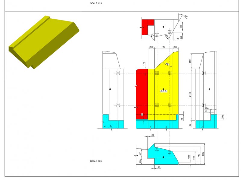

spittle Posted May 16, 2011 Posted May 16, 2011 I can't get it to work. As soon as I block it, it will not change to the colour of the layer that I place the block on. Quote
tzframpton Posted May 16, 2011 Posted May 16, 2011 Can you just use MVPARTCONVERT instead? Probably be better to use MvPart anyways. Mass Element always goes green for me. Is this what it's doing for you as well? Might be something you change in the Display Manager or Style Manager. I never really found a good use for a Mass Element so I never dug in that deep with them. Quote
spittle Posted May 16, 2011 Author Posted May 16, 2011 Are MV parts save in a separate database? So I can edit the MV part and any instances within other drawings will update? That would be ideal. One thing I've noticed (a little off topic) is when I use 3D solids rather than mass elements for objects with a radius, my 2D sections get a load of extra lines that are a bit tedious to delete each time. Do you have any suggestions? I'll try the MV part tommorrow. FYI, this is the type of 2D output I'm generating in this instance. (Note, the cyan section should be yellow) This is just a small part of the PCC benching within an underground wetwell. To follow in other drawings is pipework, steelwork, M&E etc. Quote

spittle Posted May 25, 2011 Author Posted May 25, 2011 That's what I've done - I can get the 2D linework to display as per the colour of the block i.e. the colour of whatever layer the block is on however here is the problem: The 2D linework colour does not seem to be affected by viewport layer overides - so I'm stuck with the one colour for every viewport where as I want to make different objects stand out in different viewports. Quote
tzframpton Posted May 25, 2011 Posted May 25, 2011 That's because it's an AEC entity. You're stuck with those colors unless you change the layer and regenerate the section. Sectioning tools have their strengths and weaknesses, look like you've found a weakness of them. You could always explode them for editing purposes but then you lose the link. Quote
spittle Posted May 25, 2011 Author Posted May 25, 2011 So if you wanted to create multiple views of the same 3d model, with different viewports focusing on different elements then.... ... you'd make them all the same colour or switch some objects on/off. Ideally I want to create my 2D linework from 3D models within XREFs... Quote
tzframpton Posted May 25, 2011 Posted May 25, 2011 I've never had to do extensive editing to my sections and/or elevations. You could always trace over the section with the proper linework color if you want to represent variations in your line thicknesses. This is still a manual process, but you don't break the live link between the selected 3D model components with the 2D section either. When selecting the 2D section, in your right-click menu you have an option to edit the linework to a certain degree. You can't change linetype or color, but you can delete and edit certain aspects of the view. Just kind of the way it is I guess. Revit addresses this issue in a much better fashion so I've heard. Quote
spittle Posted May 25, 2011 Author Posted May 25, 2011 This seems very limited. I'm tweaking the design as I go so drawing over the top of sections is not an approach I'd like to adopt as my drawings keep changing. Any idea if it's possible to create a style that gives you control with viewport layer overrides? If that were possible I'd go the mass element route... Quote
tzframpton Posted May 25, 2011 Posted May 25, 2011 Does the sectioning tools not display something correctly? Is there a true problem, or is it just a preference you're after? Quote
spittle Posted May 25, 2011 Author Posted May 25, 2011 It displays everything, but here's what I'm after: Viewport 1: Detail plans/sections of component 1 in bold, component 2 and 3 need to be shown but only lighter as these components will be resting on top of eachother. They're pieces of a puzzle. Viewport 2: compoent 1, component 2 in bold, compoent 3 Viewport 3: only component 3 in bold The above is a very basic explanation. the 3D sections do represent what it there and I can edit the lienwork but I need more control over line weight and linetype then I can stop messing around and wasting time duplicating 3d objects and I can just pull my sections directly off the XREFs. Quote
