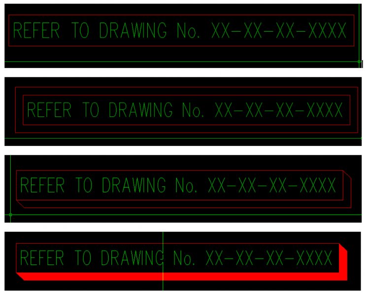

I'm trying to replicate a simple process of drawing a rectangle & offsetting it outside by 2mm.
After this process, i draw 2 lines from the bottom left hand edge and the top right hand edge at 45degrees, then filleting the two to create an isometric offset.
I then fill the area with a soild hatch, making the entire boxing red. (See image below)
25s7qx5.jpgIn short:
The attached .png van be replicated with a lisp routine, at what difficulty or cost will it be to me?

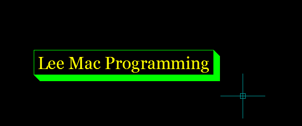

maybe make a block with attribute ? :?
kruuger
kruuger
Agreed. A attributed dynamic block with a stretch parameter would be the easiest and most sensible option. I see no need for coding this.
Agree, I would visualize something like the following:
Sadly, I cannot post the drawing since I am using a Student Version :(
EDIT: Looking at the GIF, I would move the basepoint to the bottom-left corner of the inner rectangle :oops:
Or select all objects for the flip parameter, but obviously it's still a little wonky with the insetion point.block.gif

Same thing, apply a stretch parameter (look at Lee's example to fit the box nicely around the text.

Looks like you already have it, and as far as multiple lines, just use a multiline attribute.
