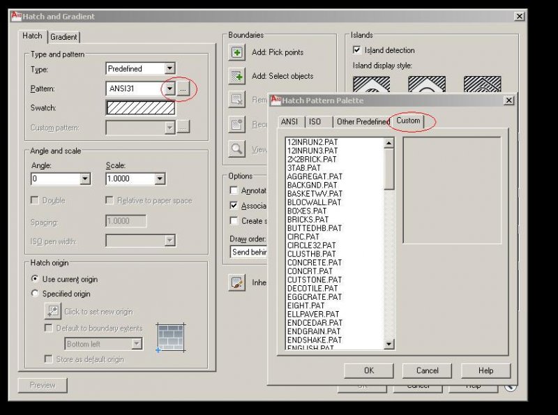

I downloaded some .pat files and I put them in a place that I created as a support path in AutoCAD. When I open the hatch command though I do not see any of the hatches. Do I need to do anything else to see these hatches?
Not sure how it looks in LT2012, but in 2010 full version, when you bring up the hatch dialog box, next to "pattern" there is a button with three dots (...). Click that, then click on the "custom" tab. Your hatches should be there.
Looks like this on mine:
Ha! Why would I want to push that button, it makes TOO much sense. :)
Yeah, that was it, thanks!!!
Autodesk likes to hide things sometimes. Glad I could help.
