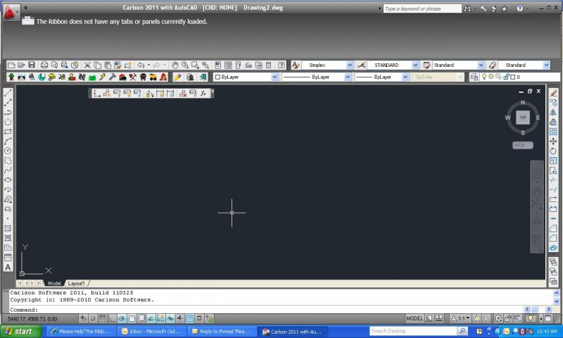

Please Help"The Ribbon does not have any tabs or panels currently loaded" Error
My computer crashed and IT just installed new Autocad 2011. When I enter the ribbon command I get the message "The Ribbon does not have any tabs or panels currently loaded."
I know this must be an easy fix but please help me so I do not have to call IT back!!

Also I have a attached a screen shot of the image too...please let me knowCADwtf.jpg
You are running Carlson Software, which hijacks the AutoCAD menu system replacing the defaults with Carlson's - and on top of that, they do not define any Ribbon tabs or panels in their menus.
So what you are seeing is normal in the Carlson world. You should be able to change profiles to get back to the normal AutoCAD menus, but your Carlson stuff may not work unless you are in their profile.
