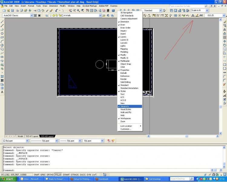

fosbie Posted May 26, 2011 Author Posted May 26, 2011 I've spent the last couple of hours trying to get the page layout right and scale etc. I don't think I'm far off but I haven't been able to set the scale up properly. When in the A0 layout view, if I right click and do Page Setup Manager and set the scale to 1:50 then my drawing and the border become tiny. Any suggestions? I've included the file. Test Plan A0.dwg Quote
qball Posted May 26, 2011 Posted May 26, 2011 Your Viewport Scale is set to 1:50, which is correct. So you're Plot Scale in your Page Setup should be 1:1. Quote
fosbie Posted May 26, 2011 Author Posted May 26, 2011 Great, glad its all setup right finally. I've found where it says the scale is 1:50 by right clicking on the viewport border and doing properties, but I can't change it through that. Where am I meant to edit it? Quote
qball Posted May 26, 2011 Posted May 26, 2011 your Viewport is Locked (also in Properities). You have to unlock it to change it. Quote
sparkyuk Posted May 27, 2011 Posted May 27, 2011 If you havnt already got the viewports selected as shown in my picture then right click up where mine is and select ACAD then select it once you have it where mine is click on the pull down menu after selecting what you want in your paper space select the correct scale and the job is done, btw you have your view port locked so you cant do anything right now in your view port Quote
BIGAL Posted May 28, 2011 Posted May 28, 2011 Click on viewport then right button click on mouse the viewport lock is an option on the menu make sure is unlocked. 2nd make sure you have the mview toolbar open then double click to go inside mview, you can then use the toolbar and the little arrow a whole lot of scales will appear slect the one you want. 3rd a shortcut for metric when you jump into the mview a number will appear in the toolbar you can type a scale number in there 10=1:100 2=1:500 4=1:250 20=1:50 etc 4th double click outside mview then pick the window and lock it so you dont accidently rescale the window. A house plan would normally fit at 1:100 probably all plan and elevations. 5th smaller sheets just make a new layout click on label and it has copy option etc then draw a smaller bounding box to reprsent the sheet size A3 =420x297 use say 385x 265 still plot 1:1 Quote
