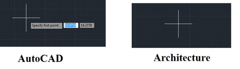

This is a very small itch that I have been having with Architecture.
In the normal AutoCAD application, whenever you type/select a command to create a point, line, box, etc a small dialog box appears near your cursor saying "Input value etc etc".
In Architecture, this does not pop-up, only showing up in the command bar.
I have tried switching profiles to normal CAD via Architecture but no avail.

I have always had that on. What I am looking for is like this pictureexa.jpg
That is dynamic input. Type in "dsettings" at the command prompt, the click on the "dynamic input" tab. Make sure all three of the check boxes are checked. Hit all the appropriate ok's and if it still don't work, you may have some other problem.
Thanks! One of the check boxes was not checked.
