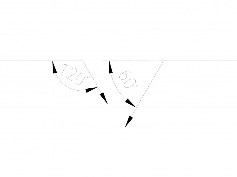

please help, i want macro for leader that has an automatic angle (60,120,240,300)...
i have one but it's not perfect, i have to make xline to get exact angle...

Use Mleader, easy to set this up using that instead of qleader.
Or set Polar to 60 and go that route.
For what purpose do you want it in a macro? If it is so you can run it in LT, then it won't work - because LT doesn't support lisp (at least not without some plug-in). And quite a lot of what's there cannot be done in normal Macro/Diesel code.
If you mean you want to call that from a macro in something above ACad LT, then you have 2 options:
  • Save it to a LSP file, then make a macro like:
^C^C(load "C:/Path/Filename")Q
  • Or copy all of it to a macro and prefix with ^C^C^P, remove new-lines, remove all the comments starting with ;, and suffix with Q:
^C^C^P(setq l_ang 60)(setq .... "orthomode" ort))(defun dtr (a) (* pi (/ a 180.0)))Q
Thanks Irneb, i was using full version before, but our company downgraded to AutoCAD LT
2011, since we cant run lisp in lt i want it to be written in macro or diesel, but if it cannot be, please help me to develop this code
