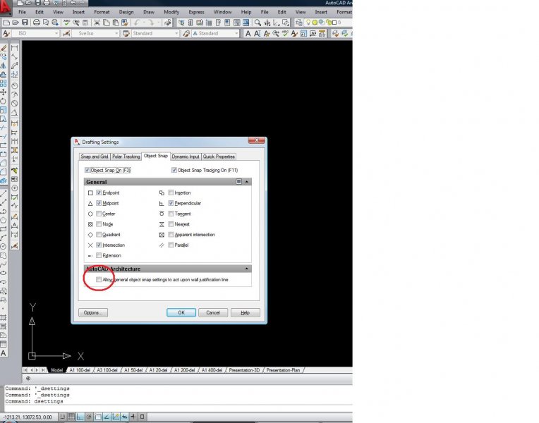

There is an object snap settings for this. On the command prompt type dsettings and enter. Under Object Snap make sure to untick the `allow general object snap settings...´ See attach picture. Hopefully this will solve your problem.
//Tobias
