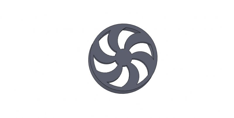

endlasuresh Posted May 30, 2011 Posted May 30, 2011 I am back after so many days anyway i was trying to draw this wheel.can somebody tell me how to draw those arcs which in center.thir are five buti need six arcs to be drawn. Quote

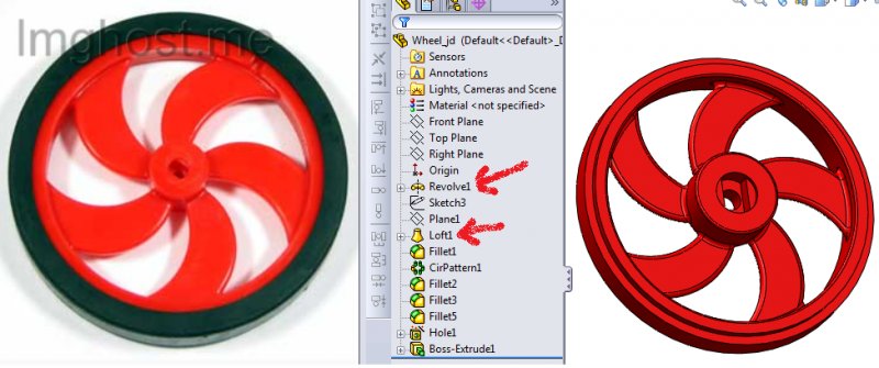

JD Mather Posted May 30, 2011 Posted May 30, 2011 Loft following arced rails on spoke. Then circular pattern. Zip and attach the file here of what you have been able to complete so far. Quote

JD Mather Posted May 31, 2011 Posted May 31, 2011 You are doing too much work. Leave out the portion between the hub and the wheel where the spokes will go. Revolve the wheel profile rather than all of those Extrudes. Are you familiar with the Loft feature? Quote

endlasuresh Posted June 2, 2011 Author Posted June 2, 2011 it looks like no replies. can some body tell me atleast to draw lines inside the circle instead of those arcs.The distance between the lines should be exact.I am thinking it is automate through circular pattern but still unable to draw. Quote

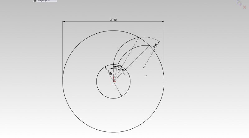

shift1313 Posted June 2, 2011 Posted June 2, 2011 Here is one method. I revolved the hub and outer portion of the rim, then drew the spoke. In a case like this the part would be a simple injection mold so i would extrude from the midplane like i did only with a draft angle. I tried to keep the file simple so it could be uploaded. Take a look at the file and let me know what questions you have. SW Simple Rim (2).zip Quote
JD Mather Posted June 3, 2011 Posted June 3, 2011 it looks like no replies. Something like this? (Feature tree is saved in a rolled up state in attached. Pull down the bar to reveal the feature history.) Wheel_jd.zip Quote

JD Mather Posted June 3, 2011 Posted June 3, 2011 I just realized that I might have made my example more difficult than it needs to be with the loft. I was thinking a elliptical cross section profile (Although I use rectangular). Looks from the picture like it might be a simple Extrude. I'll try to post some pictures when I get a chance - but if it is an extrude this should be trivially easy to figure out. Quote

shift1313 Posted June 6, 2011 Posted June 6, 2011 Sorry suresh I didnt have the time this weekend to do this. The part is fairly simple. The hub and outside edge of the wheel were done in a revolve. The "spoke" was done as an extrude using splines to define the curve. http://www.solidworkslessons.info/#!__sketching-spline For drawing a gear you will need more information than that. What kind of gear are you trying to draw? I suggest starting a new post with an appropriate title so people in the future can search for it. Please provide the info you have here plus any additional info about the type of gears. I will wait for your tutorial.I have searched on the net but theirs not one atleast.clydemit Do you know gear designing by using measurements.I searched for this too but Their are no answers and i am not a good searcher too.can you help me to draw this gear Number of teethes: 25 Outer Diameter: 40mm Inner Diameter: 33mm Gear thickness: 13mm Quote

endlasuresh Posted June 7, 2011 Author Posted June 7, 2011 I have readed your tutorial but spline is breaking angle of arcs.i am not getting an ide how to use this spline for that arcs.I have did it through tangent arc but this too not looking good. Quote
shift1313 Posted June 9, 2011 Posted June 9, 2011 suresh, i made a video of this that im producing right now. I should have it uploaded shortly. I didnt spend much time on the actual shape of the spokes or any detail but i wanted to get you the info on how to draw this thing with some draft on it since you mentioned molding this thing. Im limited to 10-12 min videos for what im doing but if you need more detail/info just ask and i will try to elaborate on the video. Quote
