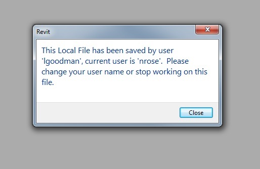

Hey guys, I'm trying to open a file that one of my co-workers last saved onto the network thru his PC and I don't understand why I can open any other file that was saved thru his PC but not this one.
Is there a way around this? The guy that saved the file last no longer works in this office and I need to modify it...
attached is the error message i keep getting....

I know this is a late reply but I just found in the options that you can change the user name.
Giant REVIT button --> Options --> change the username field.
I have no idea if this will work.
