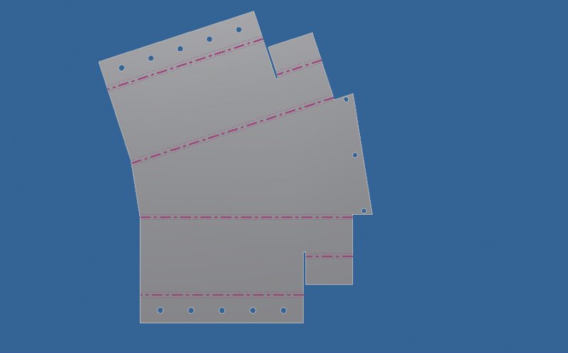

  3. I finally tried the old, "Reverse Engineering" method and just sketched out what I believe would be the finished flat panel layout and then applied folds. Funny thing about FOLD is that when you choose to FOLD in lieu of BEND, you are asked to select the BEND lines....just to be silly I guess. I also discovered that if you layout several BEND lines in a sketch and then you FOLD along one of these lines, the other BEND lines will disappear. I guess this is due to my next point...
  4. When you make a FOLD, the part may and probably will change orientation to the orginal X-Y-Z axis. I thought I constrained this original sketch fully but now that the model is finished I don't have it on an axis which I can easily select the top view and see what would be considered a correct orthographic view to provide to the CNC guys. This is another skill I need to learn about how to realign the completed model with the XYZ axis I want. Again something I can easily do in AutoCAD but need to find the information for Inventor.
The model, while finished, I'm sure will be judged as sloppy. I need to put some dimensions on it now to check that the correct dimensions are in place. And again, I still need to find a way to LOFT the finished shape and then let Inventor take care of the sheet metal layout. This is the only way I will have confidence that I can quickly layout something and get an accurate drawing which can be sent to a fabricator.

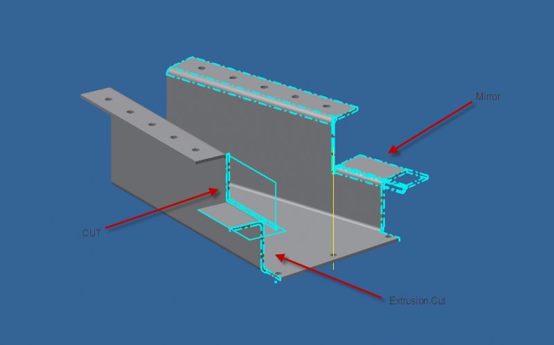

Yes I started with the bottom surface, (New Sheet Metal Part). Then flanged the sides up. Cut the flange to make the step and mirrored the whole feature to the other side.
I'll upload the file when I get home tonight...
KC

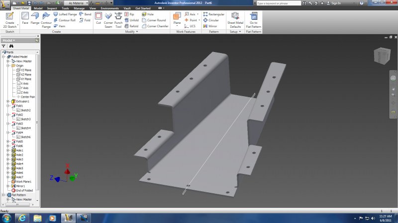

After studying till all hours, getting my daughter through her graduation, going on job interviews and shaking off a bad cold, I think I finally got this one nailed, with a few exceptions which I could use some expert advice on.
Thanks to kencaz for confirming with me his method of starting off with the bottom surface of the model. I tried to LOFT but this method is still something I need more study on with Inventor. And I think the bottom first method was actually the most efficient.
The other thing I discovered was that by using the offset method when I was adding the vertical flange, it quickly resolved the problem I was having with the bottom surface being cut off or misshaped with a radius at the wide opened end.
So in a nutshell, I created the bottom, added the flange on one edge using offset, then did a cut to get the different heights for the horizontal flanges. I then added the flanges to the tops of the vertical legs and once again, the notch needed at the transition was taken care of by Inventor, which is a good thing. The holes were added and then I simply mirrored this work to the other side.
The only problem is with the edges of the flanges which you will see in the attached PDF file. I tried doing a Move Face but this turned out to be rather difficult and didn't give me what I wanted. The flanges at the very top have enough material for me to split off but when I use the XZ plane as the split tool it slices off part of the vertical legs as well which I don't think the fabricators will actually do nor agree with.
Any advice going forward with these last two points would be appreciated. Thanks again for everyone's help. I think I can confidently say that I know 10,000% more than I knew just last Friday when I opened Inventor for the first time.

I got got the trimming (Split) part down and have the two upper horizontal flanges now halfway there. But getting the other two surfaces to extend out the proper dimension is still eluding me. It appears in the flat panel I could make these changes but then it doesn't appear in the 3D folded model. These last two surfaces are all that appears left to get the model and the flat panel into it's final form.
I was able to get the additional extensions done in AutoCAD but I'd like to have an Inventor solution for this.
