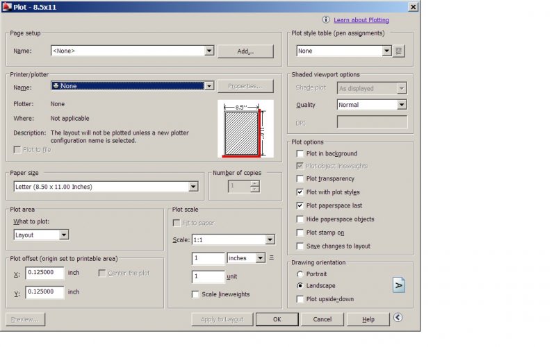

From the 10+ layers there are only 3 layers that are printing.
How can i print them all? + they are all enabled
(DWG to PDF)
Do they show if you preview the plot before you sent it to PDF?
Make sure they're not set to no-plot in the Layer Manager, and take a look at the plot options and plot styles sections of the plot manager.
I don't see any layer in the preview.

In the mean while, perhaps you could post a screenshot of your Plot manager?

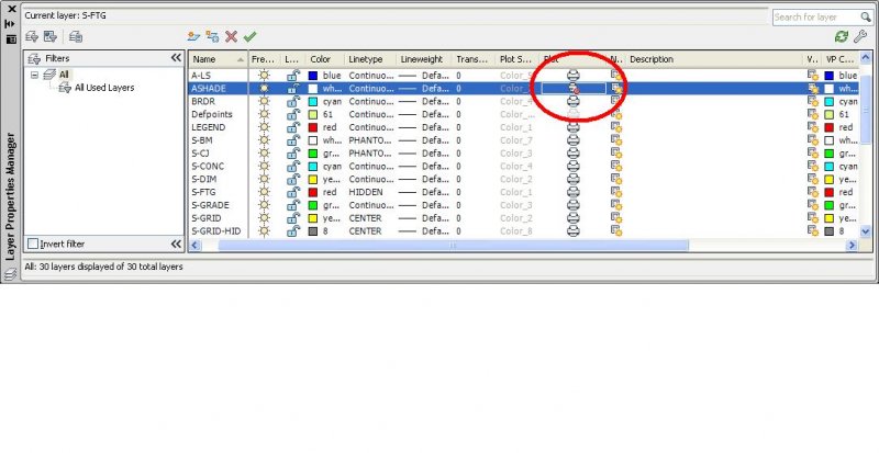

I would double-check your Layer Properties Manager settings especially since the layers are not showing up in the Preview.
As mentioned by nestly and ReMark
The one icon I've highlighted is set to No Plot. Check that out on your Layer Properties
check that your layer is not a defpoint - these are layers used in viewport when plotting but can't be printed.
Defpoints is a layer created by AutoCAD when dimensions are added to a drawing. Some long time users will put their viewports on this layer since anything on Defpoints is ignored at plot time. Since the "no print" option was added to the Layer Properties Manager this is no longer deemed a recommended practice.
