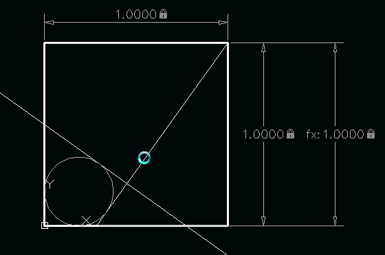

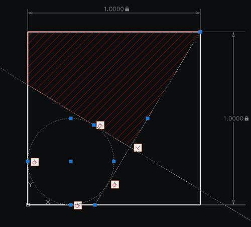

Here is a geometry/trigonometry challenged inspired by a question I found on a math forum.
The challenge is meant to be language neutral (my solution is via Excel spreadsheet), so viable solutions can be anything from written mathematical expressions to standalone EXEs. The interesting part, I think, is the procedures/algorithms each participants use to derive an answer.
The images show the relational constraints, and the challenge is to calculate the area based on a variable radius (0

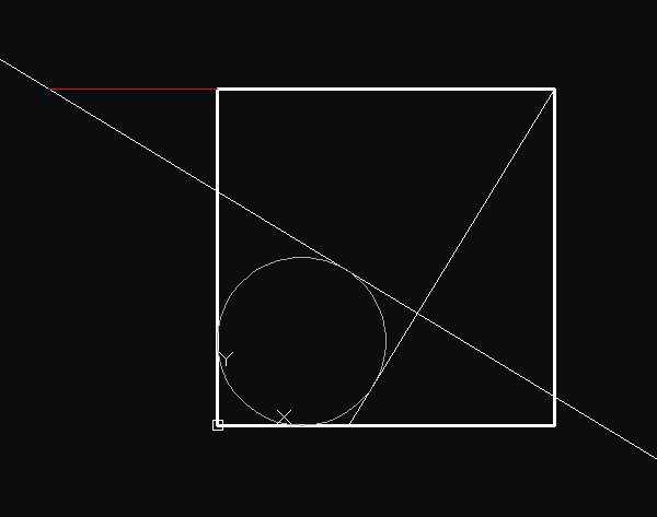

With regards to the line tangential to the 4th quadrant of the circle in the two images above, must it always pass through the top right point of the bounding box?
Yes. And the line going from lower right to upper left is always perpendicular to that line.

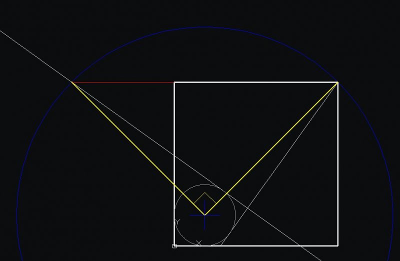

Ok, first let me apologise for the poor diagrams - its much easier to express maths with a pen and paper than in AutoCAD...
I believe the problem can be reduced to finding two lengths (marked yellow and green) by dividing the area (by red line) as follows:
After these lengths have been determined, the length of the red line in the above diagram may be calculated (using Pythagoras), and I then have all the lengths required to calculate the area of the two right-angled triangles forming the bounded area.
First, to calculate the length of the green line:
Note that the length of the main diagonal is sqrt(2) and the length of the segment from the bottom-left corner to the center of the circle is (sqrt(2)*r) (by Pythagoras on 'r').
And so, the main diagonal minus the smaller segment is the hypotenuse of the triangle formed by our green length, and the radius.
Now, using Pythagoras, I can solve for the green length.
For the yellow length:
First, I calculate the angle formed by the line from the center of the circle to the top-right corner, and the line from the top-right corner going tangent to the circle using right-angled triangle trig.
Using the fact that the angle between the main diagonal and the side of the square is pi/4, and that the two tangent lines are perpendicular, I can deduce the angle marked 'theta' (on the right).
Then, using the rules for parallel lines (sides of the square), I know the two angles marked 'theta' are identical.
Now, since the triangles subtended from angle theta are isosceles, I can get the yellow length by using right-angled trig on one of the triangles, the radius and the angle theta/2.
With both lengths, the area can be solved by calculating the area of both right-angled triangles and adding these areas together.

I used a very similar process with my spreadsheet, though I calculated the oversized triangle, the outcropped triangle, and then subtracted.
I think there are some fundamentally different methods out there – so additional participants still have something to offer. As a matter of fact, this relationship with the oversized triangle approach is rather tantalizing.

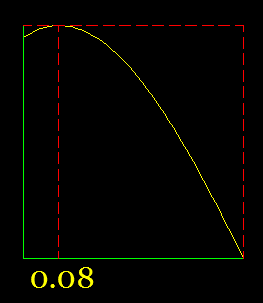

One interesting feature is that starting with a radius of 0 and the area is 0.5, then the area increases up to a radius of approximately 0.08, and then it decreases to 0 when the radius is 0.5.
I am sure that someone will be able to calculate what the maximum area is, and at what radius. :D
Interesting. That smacks of Calculus. "Extra credit”, if ever I've heard it.:geek:
Definitely, I suppose you could manipulate the algebra to get Area as a function of Radius, then differentiate to find the maximum, but that is definitely a lot of work since the function is pretty messy.
Instead, here is a quick numerical plot of area against radius:
Increment    Max Area            Radius
0.1          0.526754310161798   0.1
0.01         0.528145452121050   0.08
0.001        0.528152429205519   0.081
0.0001       0.528152940216713   0.0814
0.00001      0.528152947694428   0.08136
0.000001     0.528152947730594   0.081357

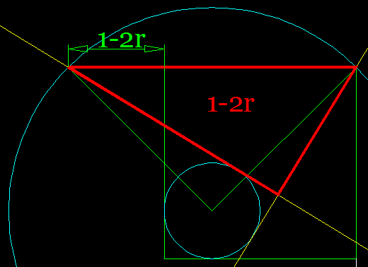

New method:
(defun AreaCalc ( r / x1 x2 )
 (setq x1 (- 1 (* 2 r))
       x2 (sqrt (+ (* (- r 4) r) 2))
 (- x1 (* 0.5 x1 x1 (/ (- x2 r) (+ x2 r))))
The method derives from the curious fact that the area of the oversized triangle (derived from the diagonals of the unit square and radius as suggested by Sean above) is equal to 1-2r which just so happens to be the length of a side of the smaller triangle (derived from Pythagoras on the oversized right-angled triangle):
This elegance is somewhat spoiled however by the method to calculate the area of the smaller triangle, since the sides of the oversized triangle are used in the calculation, which introduces ugly square roots. I strived for quite a while to find a method which didn't involve trig on the interior angle of the smaller triangle and hence retain the elegance of the solution.
