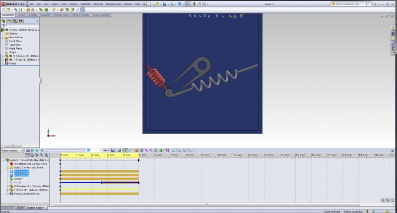

shift1313 Posted June 10, 2011 Posted June 10, 2011 There is an issue when going from an educational file to a non that wont allow me to open your motion study. Something about the way they are setup i guess. BUT i started a new motion study with your components and added springs and everything worked fine for me. It works in a basic study. I started with two springs with equal K values. Then for the 0sec location i rotated the pendulum 45 degrees(manually) and calculated the study. I took a screen shot of the initial position. Only two components and two springs. Also the only mates i have are a concentric mate and a coincident mate so the pendulum can swing. Can you tell me or show me what you added to your motion study and expand your mates in your assembly feature tree. Quote
jverre Posted June 10, 2011 Author Posted June 10, 2011 You seem to have merged three components together how can you do that ?? Here is the screenshot photo1.pdf.docx I don't know if you can see it in the screenshot but there is a problem when the simulation begins, the pendulum just goes all over the place and then just stops moving, however if i set k=0 with the springs it moves just fine =( Quote
shift1313 Posted June 10, 2011 Posted June 10, 2011 in my screen shot you can see when i have both springs selected in the motion study tree they display on the screen. On yours you have one selected but it is not displayed. Also take a look at my timeline. The pendulum component has a yellow bar next to it for the entire duration because it is moving while yours does not. I would try setting it up with only the two components like I did. Your box and the Poids component. Your box has a round boss in it so you can apply relations between it and the axis which your pendulum rotates without needing any other components. Also with your springs be careful what you are selecting to attach them to. I selected points. Unfortunately you are using SW2010 so i cant send you any files back. If i get any free time this weekend i will try to walk you through it better but i just dont have the time at the moment. Quote
