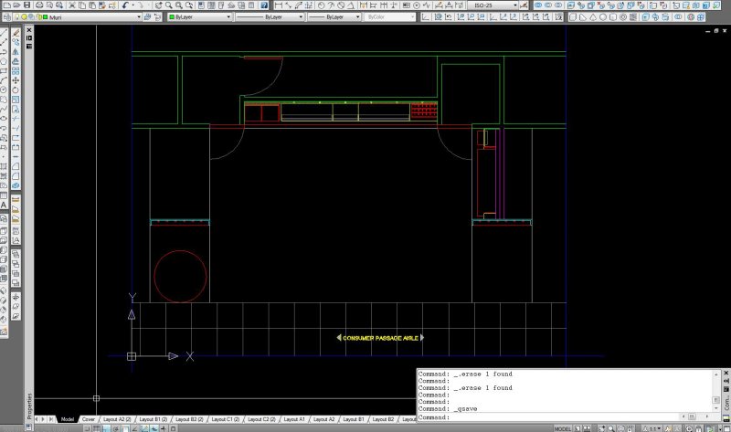

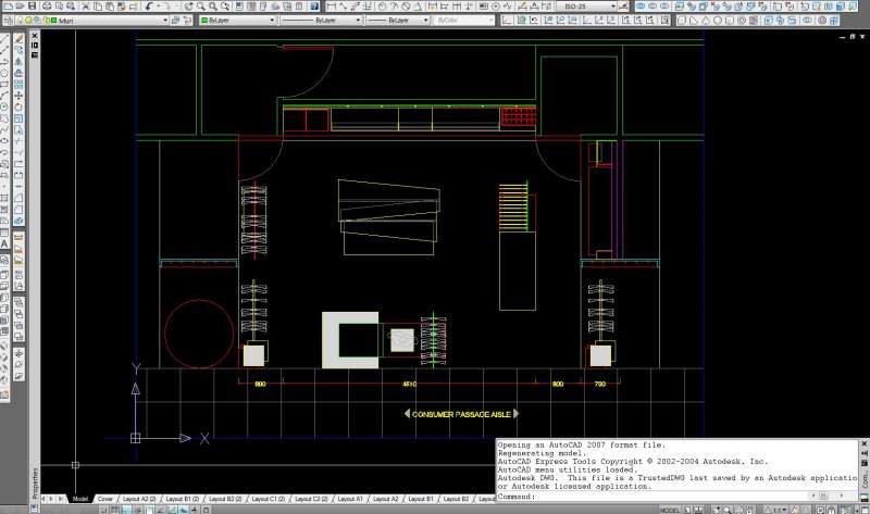

hmm... I think I realised what was wrong but I don't understand why. This is a Corner in the interior of a commercial center. So in the Ground as you see in the screenshots there r the furniture too. If I import the interior file to the 3ds I have a heavy file like I said before. I've tried to delete the furniture (2d screenshot) and import again and then I have a normal file that i can work normally on it. But it can be so big the difference in these 2 files?
Even though you can import the CAD dwg file into Max for use in building your model, it's been my experience that Max really does not like the dwg. So my recommendation would be to just import what you need. Leave the furniture out unless you absolutely need it for some reason. And delete all hatches, text, dimensions, etc. Only import what you need to build the model. And when you're done building the model, make sure to delete all remnants of the CAD file.
