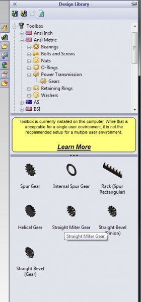

I think you need a bit more information still. There is no detail about the actually teeth of the gear. You can insert gears in an assembly in SolidWorks by going into your toolbox and the appropriate folders(see image). You simply drag it into the modeling environment then fill out the properties. The big thing you are missing from your list there is Pressure Angle.
Here is a link with some info about gears and gear design.
http://www.engineersedge.com/gear_menu.shtml

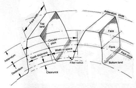

i am back as i seen earlier that the second image was not their.Anyway should i use that pitch in this helix gear and also that tooth thickness etc.
or
Should i use this pitch to the first teeth on helix gear and draw remaining Teeths ?

suresh, you will need to know the pitch and number of teeth so you know how larger your gear will be. I would only draw one tooth and create a Circular pattern for the rest, but you must first know what the diameter is going to be of the pitch circle. If you can provide me some numbers i will try to make a video for this.
