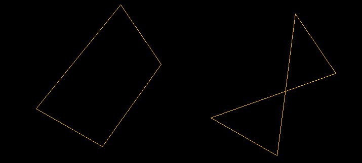

ahyin Posted June 7, 2011 Author Posted June 7, 2011 Dear VVA, Thank you for your lisp, I'm testing the lisp and found a minor problem. The lisp can't draw the correct polyline as shown below: Quote

VVA Posted June 7, 2011 Posted June 7, 2011 The program runs the following algorithm: remain only the first duplicate point. Others are deleted. I do not know how to programmatically determine what they need to keep repeating points. In your case I would suggest to try the command ECO from the topic LISP. ECO - External Contour of Objects. At least I get the required result Quote
