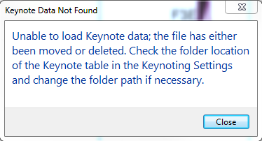

Hey guys I keep getting this error message when trying to put a 'user keynote' into my drawing. How exactly do I go about fixing this?
Okay i figured out the path to load the .txt file for the keynotes in the imperial library. Now my next question is how do I insert just a regular plan note that I can modify? i.e. one that says something like: "Light X-35 to Panel LCS" with a bubbled number and a leader.
