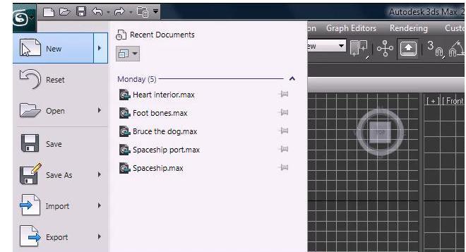

hey try this it might help,, there is a RESET under Application button(see picture below).......something like view reset it might help, it will reset your viewport and interface back to standard,,hope it works on you...from there try to create your new drawing.. just a suggestion..goodluck!
