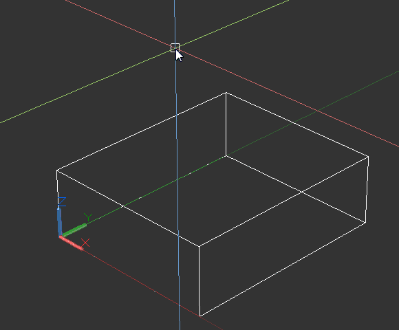

I have a rectangle and extruded it to make a box. Then I drew an edge from side to opposite side on the top side of the box. What Im trying to do is pull the edge to form an attic like structure over the box.
I can do it with the imprint command but isn't there a faster way of doing it, like in Sketchup?

I think you can extrude the edge through the sides of the box.

Draw the box. Go to front view (assuming front view is the side view in this image) draw the edge, extrude it through the length of the box and use slice command to remove the top prisms.
Then using the same edge, you can create the roof and extrude it through the length of the box.

Yes that's the type of roof. And yes that's another way of doing it, but I prefer using imprint. Anyway I've search through and through the Internet and it seems its not possible to do it without the Imprint command; there is no option for automatically imprinting lines drawn on solids...
Imprint can be automated via command macro;
^C^C_Line;mid;\mid;\;_Solidedit;b;i;\last;y;;x;x;
If the macro is followed by a CTRL+edge selection, the wholeprocess can be fairly fluid.

Wow! Cool, that's much better! I really have to put myself into learning macros and scripts...
