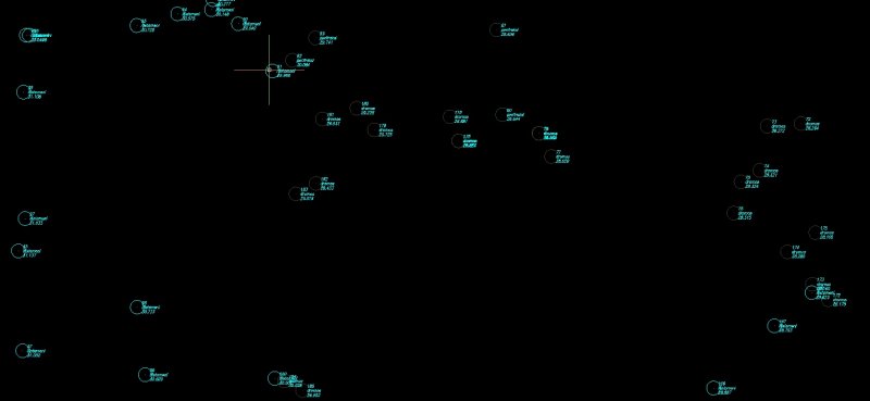

nicpapa Posted June 9, 2011 Posted June 9, 2011 Hi there, i have a lot of txt files with coordinates ,the format is : point number, x,y,z,description 1,1233.123,12341.234,113,23,description I want a lisp that import points from text , place near point the number , and create layers from description put each point into the layer and one layer for the points numbers. It is possible somethin like that? Thanks and sorry for my english.. Quote

nicpapa Posted June 9, 2011 Author Posted June 9, 2011 Thanks for the reply , i tried that lisp but it dont read the number and description , my idea to create layer from points is to work faster and dont read the description of each point because you can change the color of the layer and recognise it . i need something like yours with point name, hight , in layers and points in layer from description .I cant change or make a lisp , i have no idea with that stuff.. Thanks. Quote

nicpapa Posted June 10, 2011 Author Posted June 10, 2011 (edited) Finally i found it, after searching in google for hours i found a lisp called pointsin by Thomas Gail Haws it works perfect as i want it.. Bigal , i work in autocad with z=o , if i want contours i have a plugin to make it. I have two machines one total station and one gps and that i want to make the import xyz from my machines easier. Edited June 10, 2011 by nicpapa Quote

nicpapa Posted June 12, 2011 Author Posted June 12, 2011 Yes you can do it with topcontools , i have a topcon (the topcon can export to dwg) and the gps is javad triumph , with this i had the problem beacause it can export to dxf but it makes an dxf with points attributes with a lot information in , but i dont need all this info in my points because the autocad sometimes hangs. Now with this lisp i can export the jobs from the machines as text , and i can imprort to autocad automate points with elevation ,decription and it create layer from the description then i have another lisp that modify the layer the color as i want and thats it you have a dwg with points into layers from description with it color and now you can work faster.. Quote
