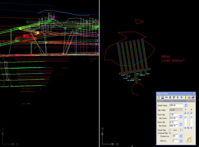

cam.jpgYes, we have good contacts with AMINE, though they are a small company and their main programmer is often away (like now) with buisiness and training... so obscure things like this often go on deaf ears...
The clipping is done in Model space, I have included a SS of the set up
on the left viewport is the mine viewing from the Right, and the viewport on the right is the level viewing in plan view
