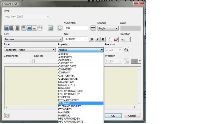

Open up the drawing template file and goto the tree expand sheet1 and right click on the border and select edit definition.
This will take you into the border editor.
double click on the line of text that you want the proporties to be attached to and this will bring up the text editor (you may have to right click and select edit text).
Under the font there is a pulldown menu called "type". expand this and select where you would like the info to be extracted from. eg - "proporties-model"

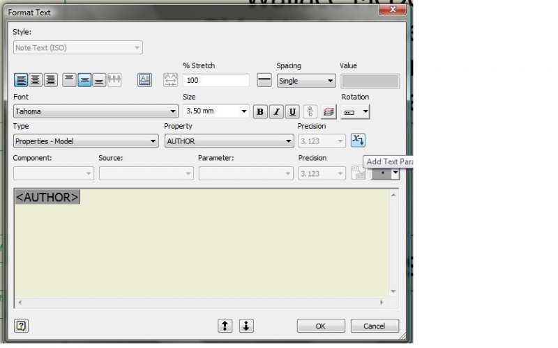

The pulldown menu next to this will become active. select "Filename" from this dropdown then click on the button with the "x" and arrow pointing down. This will add the proportie to the line of text.
Exit, saving the changes as you go.

It shouldn't do, this option only lets you have the file name. The one below it takes the path & file name.
Make sure that there is no additional text in the box.
