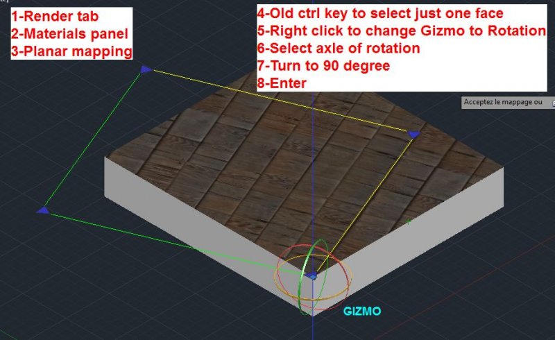

I have a 3D model of a roof on a house which I have applied shingle materials to. The orientation of the shingles is 90° off from where I want it to be. I looked into the material properties but don't seem to find a way to rotate which way the direction of the material map runs.

I don't know if the command has changed but in r14 SETUV brings up a material mapping dialog box.
In the rendering toolbar it is the tea kettle icon with a "(U,V)" text overlay r14 that is.
I don't know if the problem was resolved. If not, go to your AutoCAD help file and search for "textures, adjusting" in the index tab. The info there should be what you're looking for.

command: MATEDITOROPEN
Then click where is says "image"
you should be set from there.
