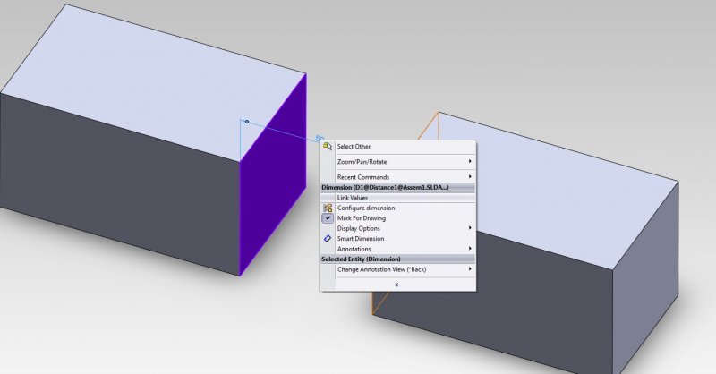

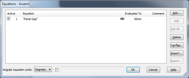

Part of your question talks about driven dimensions. A driven dimension is just one that exists. You can reference it in the equations dialog by selecting it when the equations manager is open. Also if you expand your Mates in the feature tree, you can select the distance(5000 in your case) and either link that value, use it in an equation or both. The two images show two boxes mates at 50mm apart. I double click the mate to display the value on screen, right click on it and select "Link Value". This allows me to give it a meaningful name that will display in the equation dialog. If you simply select this value(same thing, double click but then left click the dim) while Adding an equation it will display its name(D1@distanc1 for example). This name will also be displayed when you select the value on screen and can be manually typed in. I find that Linking the value and naming it makes complicated equations easier.
