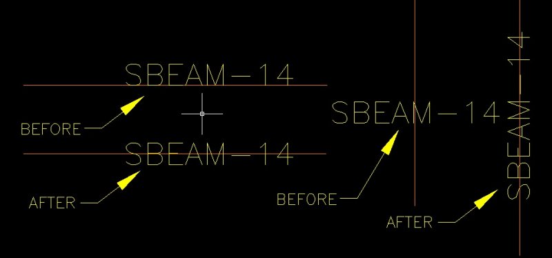

I'm trying to put the layer name on the middle of the line (not on mid point). And also how can I get also the angle of the line selected so i can place the text parallel to the line selected. Thanks.

Assoc 10 is start point and 11 is end point (angle start end) this is only for lines then (/ (distance start end ) 2.0) this is mid point distance, use (polar start angle distance) is mid point on line. A suggestion you can add a bit extra code and compare which end you have picked then swap start and end so text is correct side up. Face down and from right. like your image or add a rotate option "is text ok" N Rotate 180. use enter as "Y" else everything else is a No.
A important things the angles are always in radians does not use "units" etc.
Keeping the code similar to what you have, the program could be something like:
(defun c:test1 ( / entity point elist )

However the above will only work in UCS planes parallel to the WCS plane and also doesn't ensure that the specified point lies on the selected line.
If you didn't want to specify a point for the text, it could something like:

The above code will also work in all UCS/Views and also with Arcs, Circles, Ellipses, Splines, Polylines.. etc
Damn Lee.. You rock.. You consider everything that I wanted it to be. I added the while function and select only lines on my selection and it's all perfect now.

I added the trim command and it works perfectly on all Autocad 2009 computers but we upgraded to 2011 and for some reason, it just put the layer name but doesn't trim the line. Any idea please... Thanks.

Hi LISP2LEARN,
Quick Tip: Code is formatted better in forum posts if you don't use Tabs - if you are using the VLIDE to write your code, this option can be set under:
Tools > Environment Options > Visual LISP Format Options > [uncheck] Insert Tabs
Supplying the text insertion point to the Trim command would, in most cases, select and attempt to trim the text object (which is invalid), so, assuming I have understood the behaviour you are looking for, these would be my suggestions:

If you have any questions about my modifications, or indeed, about any other part of the code, please do ask.
