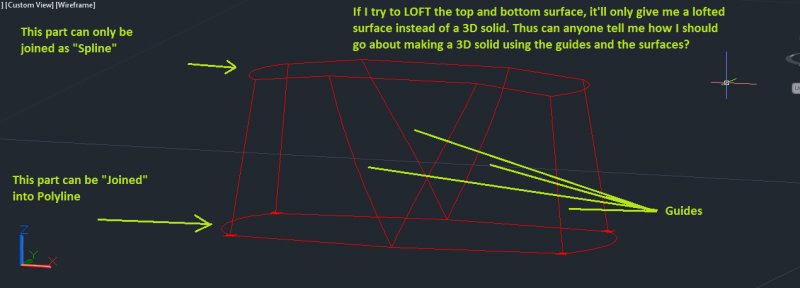

As you can see, the nature of my model forbids me from making a 3D solid using LOFT.
The top surface is consisted of 3D polyline and arc, which if "joined" will be become a spline.
The bottom surface can easily be joined into polyline.
If I loft the top and bottom, it'll only give me a LOFTED Surface, which is not I want (wanted a 3D solid)
Any suggestIon?
Any suggestIon?
Here is a suggestIon, attach the file here.
Sculpt?
