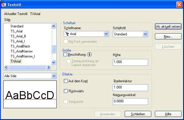

Can you post a screen shot of the style page, just in case you have missed something blindingly obvious?
I can't see anything here that would cause a problem The default height has been changed to 0.000 and the problem still persists :?
