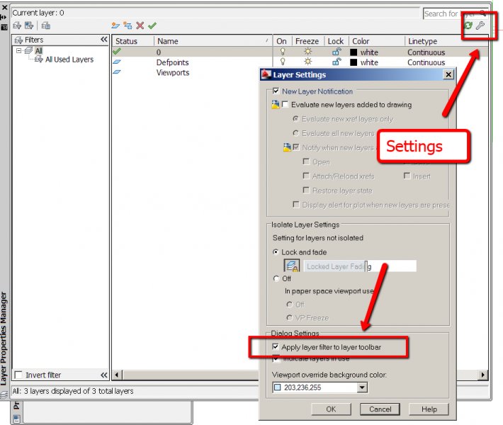

When I open a DWG-file I need to go to my layer properties manager and select "All" layers to be able to select a specific layer in my dwg.
It's not big of a problem, but it is pretty annoying when you need to open layer properties manager every time you open a dwg and select "All" just to be able to select a specific layer.
Is there any default settings that I have to change so it's selected "All" by default?

My drawings open with the same layer filter as when the drawing was last saved.
To have the current layer filter applied to the Toolbar/Ribbon controls: Settings > Apply Layer filter to Layer toolbar.
