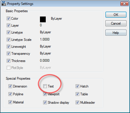

DonovanPorter Posted June 24, 2011 Posted June 24, 2011 hi guys and gals i want to match properties from one multi text to many others , but i dont want to change the rotation to suite the source .... any ideas Quote

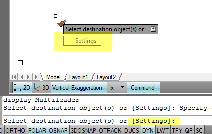

Murph_map Posted June 30, 2011 Posted June 30, 2011 Select all the text that you want to change with whatever method you like. Then you can use the properties box to change only the properties that need to be changed. Agree, or use the settings option with match properties and uncheck the text. Quote
Organic Posted June 30, 2011 Posted June 30, 2011 I never knew you could edit the settings of the match properties command! Quote
Murph_map Posted June 30, 2011 Posted June 30, 2011 I never knew you could edit the settings of the match properties command! One of the main reasons to keep the command line/prompt window open and READING it. Quote
