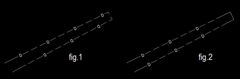

JORYROJ Posted June 27, 2011 Posted June 27, 2011 Hi, This is my first time to post in this forum, I've been reading your forum eversince the first time I've read it. got many tips and tricks and my Cad Works was never been the same. I thank you all for that. help please Q:when I am using Polyline in customise linetype (with text), the text also rotates,W becomes M, so I still need to explode it then REVERSE, just to have a nice orientaion. When I was in Australia, I have read a tip (LISP) in this forum corcerning linetype orientation, I've used it and it works. My problem is I can't find it, hope you can help me with this. thanks Quote

JORYROJ Posted June 27, 2011 Author Posted June 27, 2011 Thank you MarcoW for the response, I am laying out a drainage line that has this linetype, and all are in polyline. I've attached here two figures, fig.1 is a polyline, if you notice the D when the polyline is going to the other way, the D also rotates, while in fig.2 both have the same standing D but it is exploded and have it reversed. We are using Autocad 2011. can you help me with a lisp tha can automatically orient the polyline to have to have all the D's standing and/or on the right side. any help will be much appreciated. Quote
MarcoW Posted June 27, 2011 Posted June 27, 2011 As far as I know it is not possible to reverse only some segments of a polyline. Therefore it is a polyline. I have no solution for your problem, sorry. Maybe others have an idea or workaround. Quote
JORYROJ Posted June 27, 2011 Author Posted June 27, 2011 thank you MarcoW, your time is very much appreciated Quote

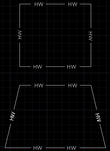

Ahankhah Posted June 27, 2011 Posted June 27, 2011 My AutoCAD works as you desired. I don't know how it is possible to force AutoCAD to do the task. As you see these are two plines. They are not exploded, but the text inside them are shown as you want. I enclose my DWG file (Test-Linetype-Orientation System Variables.txt Test-Linetype-Orientation.dwg Quote

eldon Posted June 27, 2011 Posted June 27, 2011 From reading other posts on this problem, I believe that starting with AutoCAD 2012, complex linetypes that include text, have another factor that allows the text to be oriented. Old linetypes would not have this extra written into the linetype definition, so would have to be revised. Quote
Ahankhah Posted June 27, 2011 Posted June 27, 2011 From reading other posts on this problem, I believe that starting with AutoCAD 2012, complex linetypes that include text, have another factor that allows the text to be oriented. Old linetypes would not have this extra written into the linetype definition, so would have to be revised. Not correct! I tested the status in AutoCAD 2011 and 2010. 2011 is like 2012, but 2010 doesn't show linetype orientation as mentioned above. Quote
eldon Posted June 27, 2011 Posted June 27, 2011 Not correct!I tested the status in AutoCAD 2011 and 2010. 2011 is like 2012, but 2010 doesn't show linetype orientation as mentioned above. Perhaps you would like to read this thread and then reconsider your statement. That thread says that 2011 had the facility. Quote
Ahankhah Posted June 27, 2011 Posted June 27, 2011 From reading other posts on this problem, I believe that starting with AutoCAD 2012, complex linetypes that include text, have another factor that allows the text to be oriented. Old linetypes would not have this extra written into the linetype definition, so would have to be revised. Perhaps you would like to read this thread and then reconsider your statement. That thread says that 2011 had the facility. eldon, my dear friend, "Not correct" is considering the version of AutoCAD you mentioned. I checked that in AutoCAD 2011 and 2012, which are the same. Quote
eldon Posted June 27, 2011 Posted June 27, 2011 I think that you are being patronising and not helping the OP. What the OP needs to do is to check in the linetype definition, that the R code is replaced with a U code. Then all text will remain upright. Perhaps you (Ahankhah) could do that and report back. Quote
Ahankhah Posted June 27, 2011 Posted June 27, 2011 I think that you are being patronising and not helping the OP. What the OP needs to do is to check in the linetype definition, that the R code is replaced with a U code. Then all text will remain upright. Perhaps you (Ahankhah) could do that and report back. You are right, I beg your pardon. Quote
JONTHEPOPE Posted June 27, 2011 Posted June 27, 2011 If you want to turn it the other way, in the case of lines, rotate them, and in the case of polylines, you can use this LISP to reverse its direction (not tested): http://www.turvill.com/t2/free_stuff/plrev.lsp respose from old post.. thnks! Quote
JORYROJ Posted June 28, 2011 Author Posted June 28, 2011 Thank you JOHTHEPOPE, but it's just like using REVERSE command. I do remember that I got the Lisp in this forum when I was in Australia, last February, it was a shared by a lady in this forum also. Thanks again guys, appreciate all the effort, but I will still dig from older discussion. Quote
Ahankhah Posted June 28, 2011 Posted June 28, 2011 JORYROJ, the link eldon introduced, shows the clue. As you see in the picture, you can have both patterns in one drawing: I just added a pattern to the acadiso.lin (or acad.lin). The original pattern of Hot_Water_Supply follows: *HOT_WATER_SUPPLY,Hot water supply ---- HW ---- HW ---- HW ---- A,12.7,-5.08,["HW",STANDARD,S=2.54,[b][color=purple]U[/color][/b]=0.0,X=-2.54,Y=-1.27],-5.08 I added the pattern Hot_Water_Supply_Rotated as follows: *HOT_WATER_SUPPLY_ROTATED,Hot water supply rotated ---- HW ---- HW ---- HW ---- A,12.7,-5.08,["HW",STANDARD,S=2.54,[b][color=purple]R[/color][/b]=0.0,X=-2.54,Y=-1.27],-5.08 Many thanks to my dear friend, eldon:D Quote
